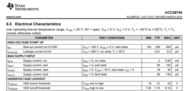

Hi Team
If the following turn on threshold voltage rang considers the temperature change drift? or it is typical value at 25℃?
Hi Team
