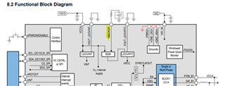

    VBACKUP IS NOT INTENDED FOR POWER RAIL OUTPUTS, DO NOT LOAD VRTC OR VINT
    The VRTC will be powered off of the VBACKUP in the event the VCCA dips below VCCA_UVLO (~2V7), this powers registers a few registers under that domain such as the Real Time Clock (RTC) and other registers to preserve under errors or low power modes. The primary usage is for the RTC, the RTC is only available when the crystal portion of the IC is populated on the respective pins. This is stated in section 8.4.1.1 Fixed Device Power FSM, see below for that snippet.

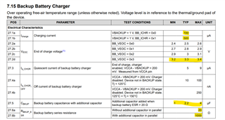

    1 Super-cap/Coin cell, Does not require any other Charging IC to charge the Super cap as the charging volage will be provided from within the PMIC.
    2
    When PMIC running on the VBACKUP current consumption is 10uA.(Regulators Disabled, No Supply on the Input of PMIC Pin)
    3 VBACKUP Charging current : 100/500uA.(Super-cap/Coin cell charging Current)
    4 VBACKUP End Of Charging Voltage : 3.3V

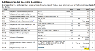

    (Can you please conform : In the Section7.3 Point R1.14 ,it has mentioned that Voltage on backup supply pin is 5.5V Max ,So It means that this pin is tolerant to max 5.5V correct ??? ,this is not Max Charging Voltage)
    5 VBACKUP Series Resistor : 20E if used without additional parallel capacitor/1K if used with additional capacitor in parallel.
    6 VBACKUP additional Capacitor : 1uF to 4uF.

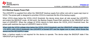

    7 VBACKUP Once the Super Cap voltage reaches under 1.7V LDO of VBACKUP(LDOVRTC) turns OFF and digital core is RESET.
  • Super-cap/Coin cell, Does not require any other Charging IC to charge the Super cap as the charging volage will be provided from within the PMIC.
    Correct
    Also correct, the device needs to be primed in a certain 'state' to reach this consumption.
    Configurable via register writes, but yes also correct.
    That is correct, you can place higher than 3V3 which is that max charging voltage you're speaking on, but the tolerance is upto that 5V5.
    Correct
    Correct, used with that additional cap/battery. The intention is with a battery.
    This is correct, at that point nothing on the PMIC will be on and no registers are preserved for the next power up attempts with the exception of what is saved in the EEPROM (NVM defaults TPS65931211)
