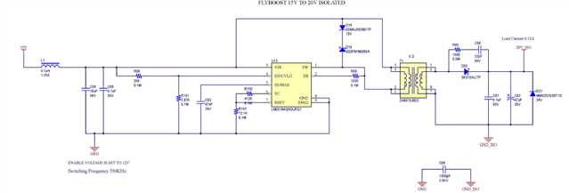

We are using LM25184 for stepping up 15V to 20V with isolation btwn input and output. Please find the below schematic. Note: C63 is DNP in design.

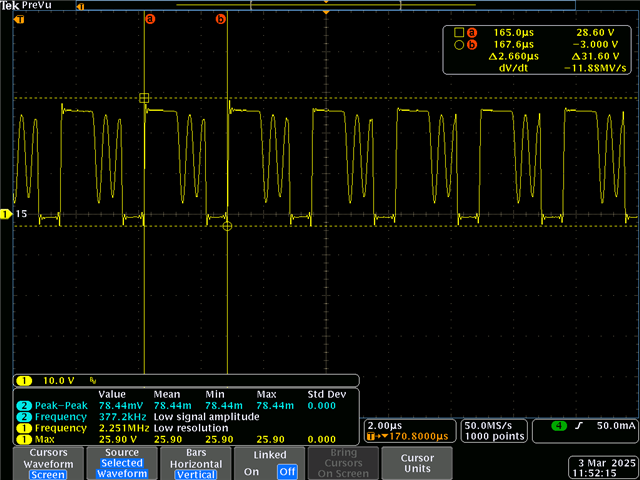

1. Switching frequency:
With input 15V and Load of 0.120A , observed switching frequency is 375kHz. Please find the waveform below.
But datasheet says max switching frequency is 350kHz. Could you please provide your feedback.

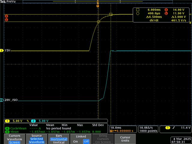

a. Unloaded condition on output(20V_ISO) , UVLO Rising observed is 11.9V

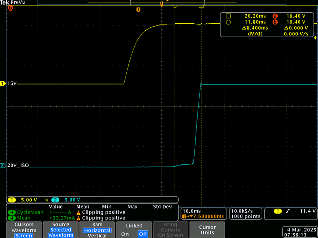

b. In loaded condition(0.12A on output ie 20V_ISO), output is rising after input voltage reaches 15V. Please find the below waveform. Could you please provide your feedback wrt UVLO Rising/Enable and Soft start in this case.

    Sorry! Yes, i have missed the waveform prior. Please find the below.

    I just followed up with design team regarding the switching frequency. Regarding the UVLO. It is interesting that Vout starts ramping up when VIN=15V. There must be some delayed happening at Cout so that it is reflecting later when the device starts switching. Could you please take (SW-GND) in addition to (VIN-GND) and Vout? We need to confirm that device starts switching after reaching 1.5V at UVLO pin (12V at VIN).

  • Hi Asha,
    The max. switching frequency value can reach 375kHz in some cases according to the experts. I hope this helps.
    Thank you
  • Is it because of internal tolerance?
    What would be the maximum switching frequency we can expect from this converter, is it 375kHz?

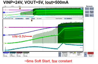

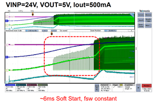

    I took waveform in the LM5180EVM-S05 (link below where you can check Schematic) and checked the Soft Start to confirm this behavior. As you can see below, the device starts switching when VIN=~9.5V (UVLO_on), but Vout (5V in this case) has not increased much yet. This is due to the high load condition (Iout=500mA in my case). During Soft Start, the controller delivers power to the secondary side with a constant fsw of 9khZ<fsw<15kHz while increasing Vin and this charges Cout slowly. After the soft start time (6ms in this case), the control loop feedback takes control and the controller switches at higher frequencies to rump up Cout sharply. This is different at no load conditions, where Cout get charged quicker as there is no need for a lot of power to be delivered to the output side.
