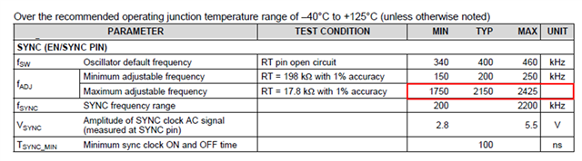

Hi team,
There is Fsw variation information in datasheet when RT used and fixed 400kHz. Can you also share Fsw variation 2.2MHz fixed operation?
