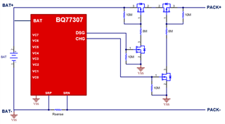

Are there any design recommendations that would look similar to the one described in the BQ77216 datasheet, shown below? This is the configuration we would like to use, however it seems like the BQ77915 is designed for lowside FET control, so we need gate driver ICs as well. My concern is having to ensure that all the protection limits align correctly between the BQs, as we would prefer the BQ76952 to be the primary protector, and then have the stackable BQ77915 as a redundant secondary protector.

    We do not have any design references to refer to with BQ77915 as a secondary protector. BQ77915 could theoretically be connected for high side, however, this has not been something we have tested on our end. The image below shows an example of how the connection could be done with another one of our low-side FET driver protectors.
    BQ77915 should be fine to use as a secondary protector. It may require testing to make sure the protection limits align correctly between the BQs. Another option potentially is to use another BQ76952 as a secondary protector as well.
