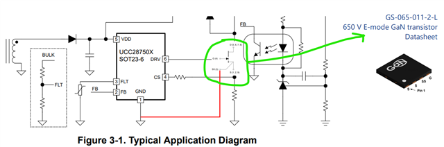

If the GaN Kelvin Source pin is connected to the controller's GND separately, the current sense path in the flyback application will be shunted, so that the controller's VCS cannot read the correct current sense value. Does this still depend on whether the controller has an independent driver source pin? If the Kelvin source pin here cannot be separated, would you recommend that I connect it to the power source pin? Or is the Kelvin source pin No connection?
Or is it possible to connect several 10 ohms in series with the Kelvin source?
  • I think you misunderstood the SS pin definition in Infineon's datasheet. SS is the gate drive ground, not the FET ground. the current still flow through the S pin, which will be captured by the external shunt resistor and monitored by the CS pin of the controller.
    On the side note, UCC28750 drive can go as high as 12V where the GaN FET takes 5V input only. You need a driver in between.
  • FET S and FET SS are connected together. This problem has been clarified. In flyback applications, the 2 pins need to be connected together. If FET SS is connected to the controller ground alone, the current sense will be shunted, causing VCS detection problems.
