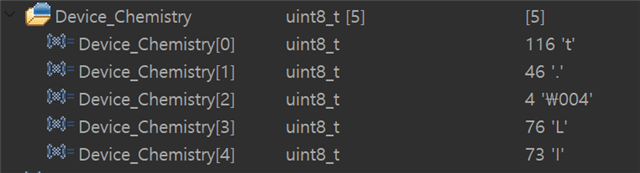

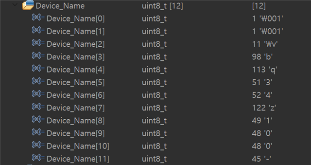

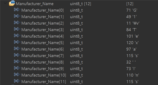

The above is the data actually read from BQ34Z100-R2.
When I compare the TRM of BQ34Z100-R2 with the data I read, the data matches up to OFFSET 30.
(Except that the Design Energy value of OFFSET 13 is read as 370 -> 5400 and the JEITA T1 value of OFFSET 26 is read as -10 -> 0.)
You can see that 3 bytes have been pushed back from OFFSET 31.
I understand that the value of Device_Name[2] in Figure 1, 11, represents the size of bytes used for Device_Name. Is that correct?
So, does that mean that the values ​​of OFFSET 31 and 32 become the values ​​of Volt Scale and Curr Scale respectively?

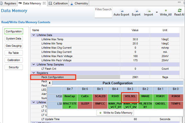

And the figure below is the Pack Configuration Register Bits table provided by TRM.
In this table, Bit 5 of the High Byte is marked as Reserved.
The image above is taken from the TI forum.
In this figure, you can see that Bit 5 of the High Byte is SCALED. This is different from the TRM.
The TRM version I'm looking at is Revision A. Has there been any update since then?
