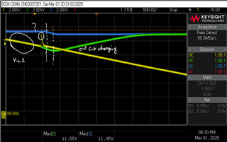

We are testing an ORing circuit using the LM73100 ideal diode controller and are encountering an unexpected voltage dip of approximately 2-3V for 6ms. I would appreciate any insights on this issue.

Test 1 (Ideal Condition - DSO Image 1: oring_01.png)
  • Initial State: First Primary Power Supply is turned ON, then Secondary Power Supply is turned ON
  • Transition Trigger: Primary Power Supply turned OFF
  • Observation: Power switching works as expected although there is voltage dip of approximately 2-3V
    It looks like the out is still supplied by the VIN1 for some time which is causing the drop and after the switch to VIN2, the output caps start charging.
    What is the cause of this spike in VIN1?
    Kindly help me understand why you think the Vout is being powered by Vin1 as the Vin1 input has been cutoff. During the switch over the Vout is powered by the Cout.
    I am unaware what would cause the voltage spike.

    Your primary supply (yellow channel SMPS) is somehow not turning off when dropping below 11V (uvlo threshold set). I suspect that either probing is mixed between SMPS and Aux power supply and yellow is Aux channel as it looks like it is turning off at near 8.7V (UVLO threshold for AUX channel) or resistor got mixed or some other voltage rail is keeping EN high. Checking EN and OVLO voltage for both channels will help you in debugging.
