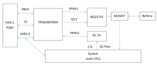

  • Hi Xavier,
    Can you confirm which device and GUI you are using? (TPS65987D? H/K , 6.1.4?)
    Can you share the .pjt file you are using?
    How are you controlling the BQ25723? How/when does it charge vs. supply power?
    Can you provide a simple block diagram of your system showing the battery, system power rail, and type-c related blocks?
    I don't know of a way for the TPS65987, by itself, to specifically disable the sink path on USB-C default contracts. You would need an external I2C host in order to implement something that does this.
    Typically you would configure the Power Path used to be "Wait for SRDY" in the "Global System Configuration" register. What this does, is when the part is sinking power, it will not close the sink power path until an "SRDY" 4CC command is sent from an I2C host. You would need to set up the interrupts for "New contract as Consumer" and maybe "Plug Event" to indicate to a host that it needs to check the PD controller and potentially send an "SRDY".
    If you are using the I2C controller events table to control the BQ25723, there may be other options, but I'm not sure if they would work and would need to see your current pjt before making any decisions.
    I use the TPS65987D I2C3 connection to the BQ25723 for control.My board is designed to be an OTG device, which will supply 5V to the outside when it is a master device, and an external power supply to the board when it is a slave device.
    Here's a sketch of my board

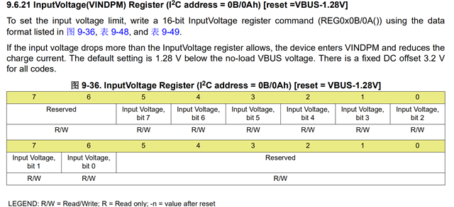

    I do use I2C controller events table to control the BQ25723,recently in my testing I found again that the BQ25723's Dynamic Power Management (DPM) function can meet my requirements,it is also a register that can be written to.
    The DPM register address is 0B/0A and the picture is its description.
    I set DPM register value to 0540, which means limiting the input low limit to 4.544V. Here's my process for doing that, when I plugged my board into the PC, I used the EV2400 to write 0540 for this register on the BQStudio and found that the PC would not prompt for a surge, and the PC's USB voltage didn't dip below 4.544V, meaning that the modification to the DPM worked.
    However, when I tried to write this register via the TPS65987D, I set up some I2C control events, and was not able to write to this register after connecting to the PC (i.e., 5V power supply without Sink PDO Negotiated), except for setting up the I2C control event to Sink PDO4 Negotiated, which allowed me to write this register successfully.
    It looks like this register is reset when the BQ25723 is connected to VBUS.
    Maybe you can figure out how to write a value to the DPM's registers using I2C's control events after plugging in a 5V VBUS without Sink PDO Negotiated.

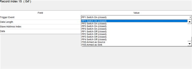

    Also, I was trying to use the I2C control event 'PP k Switch On' as a DPM write condition, but it didn't work.Because all the 'PP k Switch On' in my pit file shows 'PP k Switch On (Closed)', I don't understand if it's because of this 'Closed' is the reason why I can't successfully write to the DPM registers.
    Nice! This sounds like it works well
    I'm assuming here that it means the switch is "closed" in the on state. I have seen this event used too often, but it seems like it triggers when the Power path in mention is used.

    I have tested almost all I2C events, including “Cable attach CC_1/2 PD”, and none of them are able to write to the VINDPM register at VBUS=5V.
    In my testing, I found that the BQ25723 writes the default value “VBUS-1.28V” to the VINDPM register once after receiving the power input, which is bound to happen.
    Thanks for the explanation. It sounds like it meets my trigger needs, but it really didn't take effect when tested, which puzzled me .
