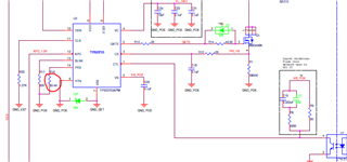

Hello TI Team,

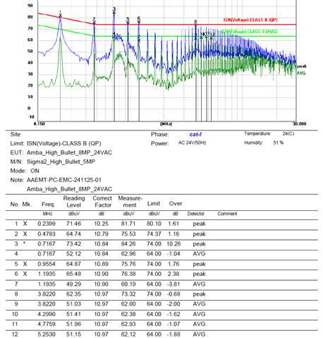

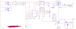

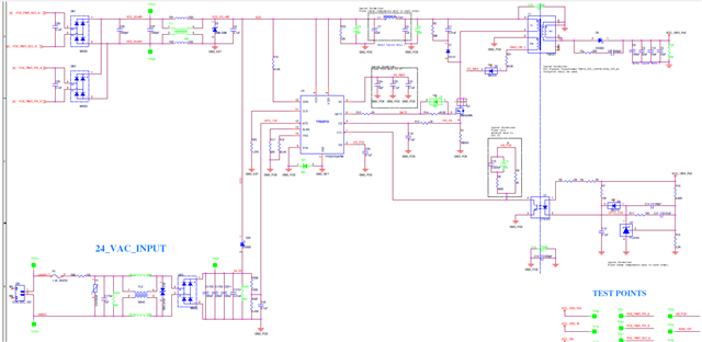

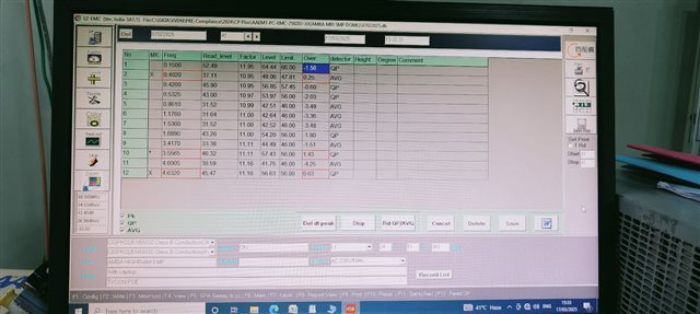

We are failing into conducted emission test for the 24VAC input path, while it is passing with POE path. Below is the circuit diagram of both the path with PD controller.
This is TI EVK SCH

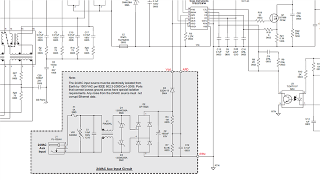

We have tried to implement same circuit of 24VAC from TI EVK SCH but have used some different components.
The CMC used in our circuit is ACM4520-142-2P-T000, While in TI EVK it is P0420NL. Do you think that our CMC will not work here for the CE?
Can you please suggest us solution to pass the CE?
