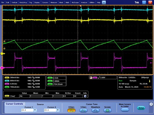

    The below is the waveform.
    And sorry, VIN voltage value in my previous post was not corretct. The VOUT start to drop at VIN=around 1.55V.
    In the previous post, I just read the value which showed at power supply unit.
    Anyway,  VOUT just start to drop at VIN=1.55V. The valley current is about 1.8A

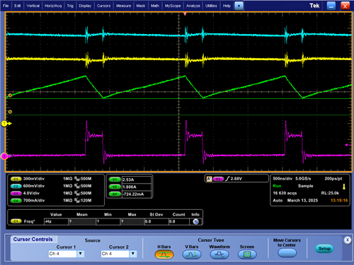

    I slightly decreased the supply voltage. The inductor current increased, but VOUT decreased.

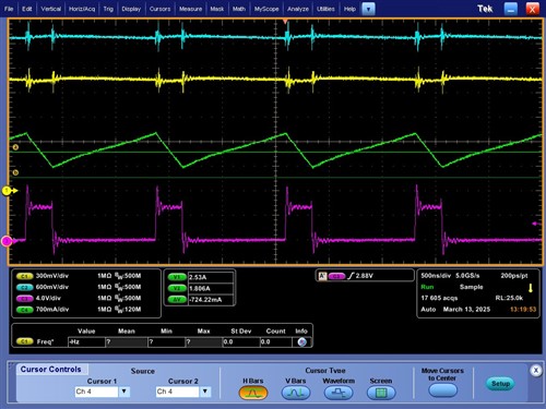

    I slightly decreased the supply voltage more. The inductor current increased more , but VOUT decreased.
    The valley current is about 2.5A. This valley current doesn't increas anymore.
    Satoshi Obata
  • could I see to it when back to office?
    Have you seen it?
    Satoshi Obata
  • Hi Obata, at the edge of the current limit , the loop is not stable, sense ratio may be changed , then you could observe these behavior close to current limit .
