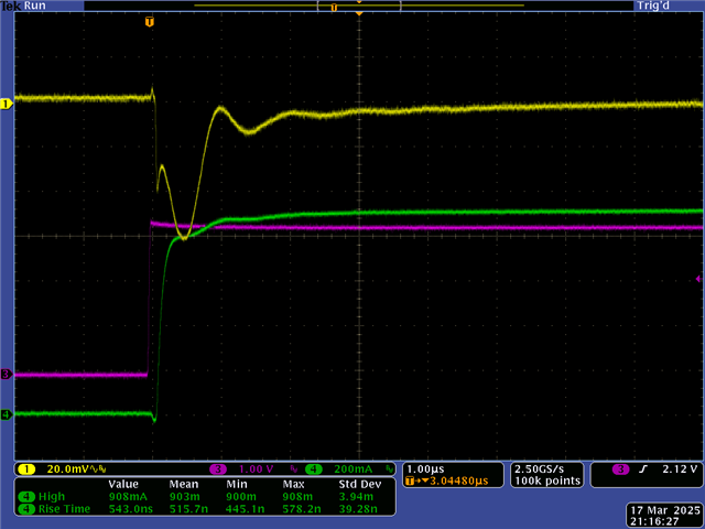

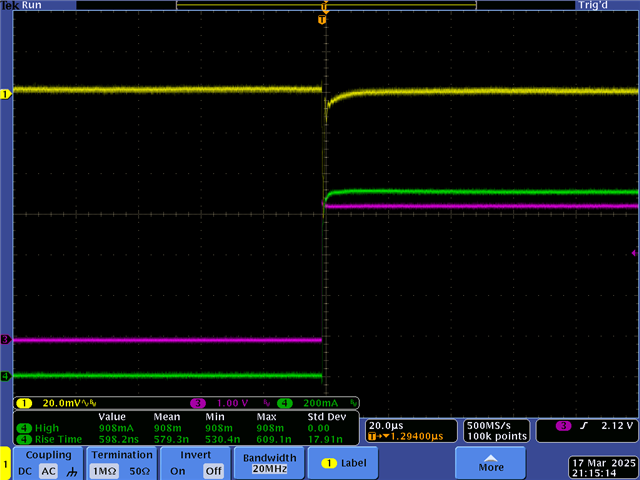

Would you please help us below transient test waveform if you have TPS74801 EVM on hand?
Vin 1.8V to Vout 0.9V, 0~1A, 50A/us slew rate(if your eletric load can support this slew rate)

Hey Jeff,
Thank you for your patience, sincerely apologize for the delay. Unfortunately, we were not able to achieve a slew rate of 50A/µS. The fastest we could achieve was 2A/µS. Trying to go faster would require custom hardware.
