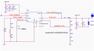

The customer is currently using TPS54335 in a machine vision camera project. Recently, two cameras burned out. When the customer checked the problem, he found that the current circuit could not pass the simulation.
1. The customer calculated the compensation circuit according to the formula in the manual. Is the simulation inaccurate?
2. According to the formula, the value of R4 is only related to the switching frequency of 1.5MHz, the output voltage of 15V, and the output capacitance of 22μF. The calculated value is 37.4K. However, the simulated value is only about 15K. Why is this?
Below is the schematic:
Please help analyze the reasons, thank you very much!

    two cameras burned out-- did TPS54335 burn out? Did customer measure is there any short-circuit between the pins  like Vin , SW, GND ?
    What's the load and can you please share the part number of the L8?

    According to the formula, the value of R4 is only related to the switching frequency of 1.5MHz, the output voltage of 15V, and the output capacitance of 22μF. The calculated value is 37.4K. However, the simulated value is only about 15K. Why is this?---The Cout customer chose is <22uF(please check the capacitance derating under the DC bias).  What's the Cout in the WEBENCH simulation ?
