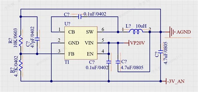

Customer was designing a inverting buck-boost for Vin=20V, Vout=-3V/0.3A.
Could you please help review their schematic? Thank you.
Hi Aki
EN max voltage is 6V, customer can leave EN open;
Please select Cout according to 3.2.2 Output Capacitor Selection in this publication:https://www.ti.com/lit/an/slvafh1a/slvafh1a.pdf?ts=1741239181678&ref_url=https%253A%252F%252Fwww.ti.com%252Fproduct%252FTPS62933F
