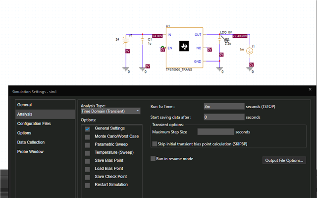

I'm trying to simulate the unencrypted Spice file for TPS70960, but it does not output 6V despite closely following the application notes.
I also tried simulating it on PSpice for TI and the same thing happens - the output is stuck at 2 mV for an input of 24 V even when loading the output.
Is possible to get a fixed version of the unencrypted Spice file for TPS70960?
Many thanks!

    I've tested with the current version of the unencrypted TPS70960 model from the product page and cannot seem to reproduce this in PSPICE 17.4, PSPICE for TI, or TINA-TI. Transient and bias point simulations both reach the expected 6V output with a 150mA (40Ω) resistive load.
    The one issue I experienced was related to the NC pin. Tying NC to GND short-circuits an internal voltage source in the model and causes a simulation error. Leaving NC floating or adding a series resistor between NC and GND resolved that issue.
    Can you share the circuit you're trying to simulate, as well as the type of simulation (transient, bias point, DC sweep, AC sweep) you're trying to perform?

    Here is the circuit I'm trying to simulate.
    Could you also share the circuit and simulation settings that got it to work?

    It looks like although the TPS709 enable pin can be left floating to enable the device, the model does not account for this behavior. If you connect EN to VIN in your test above, the model should behave as expected.
