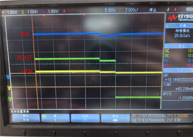

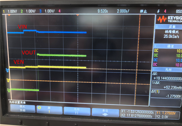

  • Hi Ishann,
    Today I did test with customer, and find what customer said. Below is the waveform. You can see that when VEN falls below 1.2V, then VOUT turns zero. Note that VIN is above 3V and did not rigger UVLO.
    Below is EN rising waveform. It is the same as I stated in the past. What might be the reason for this?

  • Hello Bengi,
    0.7V and 2V are the limits at which we can definitely say the part is OFF or ON. However, the device turns on and off in between these values.
    See the following graph for where you can expect the device to turn on and off. They seem to line up with what the customer is seeing.
    ~ Aaron
