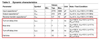

To do so, reduction in rise and fall times is indeed.  The rise and fall times of the MOSFET (BSC220N20NSFDATMA1),  I have used is attached.
The same for the LM5034 gate drivers are also attached.

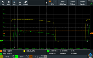

But, the observed rise and fall times are around 50ns. (Refer below waveform)
Note: The gate series resistance of this MOSFET is 0 ohms (20 mohms).

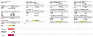

The power loss for the MOSFETs are given below.
