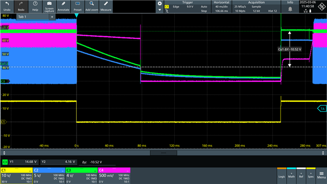

I have question regarding the Comp pin of TPS92692-Q1.
Comp pin (Ccomp) was discharged from 1.67V to under 1.6V when external PWM signal is off. I want to know this discharging time. Could you let me know the resistance value (or leak current) of the Comp pin ? Is it over 15 Mohm ?

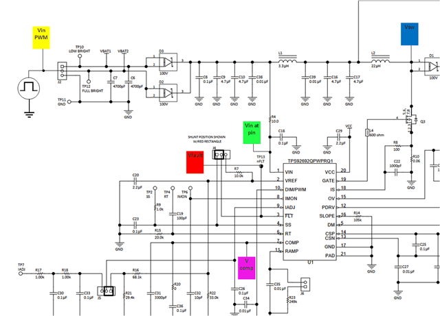

    The answer to this is complex and depends on a lot of factors such as your input voltage, input capacitance, and current draw which will affect the time it takes to reach UVLO of Vcc. The COMP pin is likely falling to below 1.6V because the off time of your PWM signal is too long and the Voltage at the Vin/Vcc pin is likely droping below the 4.1V UVLO threshold. Please see the wave forms below. Fig 1. through Fig 3. represents an increase in input voltage, and thus, in increase in discharge time, prolonging the time it takes to reach UVLO. Fig 4. represents the Vin reaching the UVLO and triggering a fault. Fig 5. shows the nodes which were probed labeled with their respective names and colors.
    Fig 1. Ch1: Vin PWM, Ch2: Vsw, Ch3: Vin at pin, CH4: Vcomp
    Fig 2. Ch1: Vin PWM, Ch2: Vsw, Ch3: Vin at pin, CH4: Vcomp
    Fig 3. Ch1: Vin PWM, Ch2: Vsw, Ch3: Vin at pin, CH4: Vcomp
    Fig 4. Ch1: Vin PWM, Ch2: Vsw, Ch3: Vin at pin, CH4: Vfault
    Fig 5. TPS92692 880 EVM Boost schematic, showing the nodes which were probed in the wave forms above
