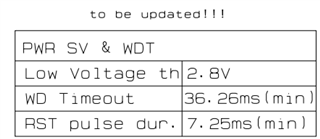

Can you please review this schematic and give me feedback by latest 10th of March!
Thank you!
Bests
Oscar

Hi Oscar,
The schematic looks good. The timing table that says that is still needs to be updated is indeed out of date from the schematic, not accounting for capacitor tolerance the WD timeout would be 23.76ms and the RST pulse duration would be 10.69ms.
Joshua
