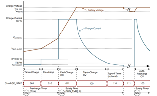

Does the charging curve of the chip when I use a constant voltage load as an output match the graph below?
    The constant voltage load will work well during the BQ25756E's constant current phases. The constant voltage load will not work well during the BQ25756E's constant current phases. I recommend using a constant current load to test the taper charge phase.

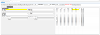

    I am trying to program the BQ25756E using bqstudio, but I am making the chip work with EV2400 recognized by bqstudio, and I am doing read register
    operation in D4(6A) address, but the page is showing 'DEVICE ACK ERROR', I would like to ask how to solve the problem?
    I have a few suggestions:
    • Make sure the IC has power.
    • Make sure the EV2400 is plugged in before starting BQStudio
    • Make sure the I2C lines have the correct pull ups.
    Let me know if those work.

    All three of these conditions have been met so far. bqstudio has recognized the EV2400, SCL and SDA both have 3.3V pull-up voltages, and I have 6V DC
    input to both VAC ports (32,33). But when I finish all this clicking on 'read registor' still shows 'device ACK error'.
    I'm currently thinking that there is something wrong with my circuit setup because I'm currently reading the registers with a 6V input to the VAC, a low CE port,
    and a 7V constant voltage load on the output, and the load side rises to 7V within 10s when I input the voltage, so is it possible that I'm getting a higher
    voltage on the constant voltage load and thus failing to program the I2C? And the chip will start working after inputting VAC, is writing registers at this time
    affecting the chip's operation? What do you currently feel could be the problem?

    When you apply voltage to the charger, can you try applying a 6V DC source to VBAT and see if that 's any different?
    I think this might be the charger operating with the default settings.
    Can you check SDA and SCL with an oscilloscope to make sure the signals are being sent correctly?

    That's what I thought too, but when the IC has power it starts working as per default settings. As I understand from referring to the BQ25756EVM file, the I2C
    programming is to read and write register when the IC is working, and I am wondering if the 'ACK error' was generated because I clicked on 'Read Register'
    without having written the initial value of the 16-bit registers in the figure below. Or is it that clicking 'Read Register' should be done in the '8 bit Register' page,
    and then the corresponding register bit will show the corresponding register value of the current chip?

  • Can you check SDA and SCL with an oscilloscope to make sure the signals are being sent correctly?
    I can only observe 3.3V at SDA,SCL.
    When the charger first starts up, the registers are pre-written and the charger uses the hardware settings to determine the charge current, charge voltage, and other settings. Clicking "Read Registers" shouldn't cause 'ACK error'.
    I have a few other questions here:
    • Do you see SDA and SCL being pulled down whenever you click read registers?
    • Do you see any difference if you use the BQ25756E BQZ File? Both the BQ25756 and BQ25756E BQZ files should work.
    • Have you tried changing the USB port the EV2400 is plugged into?
    I tried again but I can't see any voltage change.I would like to ask if the EV2400 produces a voltage change when I click on 'Read Register' without connecting the chip? At the moment I don't see any voltage change with or without the chip connected.
    I installed the 'bqstudio-test' version with the BQ25756E BQZ file as follows.
    I did it too but it doesn't work either.
    Thanks in advance!
    Yes, you should see the SDA or SCL lines being pulled down when the EV2400 tries to communicate with the BQ25756E.
    Can you install this file: https://e2e.ti.com/support/power-management-group/power-management/f/power-management-forum/1379348/faq-bq25756e-bqz-file-for-bqstudio ?
    And move the file to BQStudio's config folder? The default folder path should be C:\ti\BatteryManagementStudio
    I have a few other questions to try to debug this:
    • Is there anything else you can tell me about your system?
    • Do you have any other EV2400s or EVMs to try to communicate too with BQStudio if possible?
    • Can you try communicating with the EVM with a different computer?

    I installed the file,changed the computer and tried again but still no work,I've decided to redesign the PCB circuit once again, as my current circuit is designed primarily for programming resistors. Since I only have one EV2400, I'm going to try another one.
    Before I redesign the circuit, I have the following questions:
    1.Does the BQ25756E have to differentiate between PGND and AGND when designing the circuit?
    2. Do the SDA and SCL pins of the BQ25756E need 10k resistors to connect to the EV2400?
    3. Can you provide a PCB file for the BQ25756E?
    Thanks in advance!
    1. No, you don't have to differentiate between PGND and AGND.
    2.The SDA and SCL resistors will need the proper pull up resistors. 10kΩ pull up resistors to 3.3V will work when using the EV2400.
    3. Here's the PCB file of the BQ25756EVM:BQ25756EVM_Design_Files.zip
