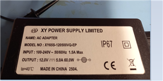

  • Hi Chris,
    Please see the pictures attached with power supply and mesurement on My Fluke 45 at the PPHV output => 0VDC with your recommended configuration.
    Pigs.zip
    If the SINK_EN pin is high, that means the sink path is disabled => I agree!
    For the Type-C power supply you are using, what are the power capabilities? => see pictures
    What voltages can it supply. => 12.85 V measured at VBUS
    No change with different PS.
    When I said it doesn't, it doesn't work. I'm sorry.
    I think that I will have to buy an other one from Mouser for 159.06 Euros to test it again before to run our 3000 PCB's production and I'm not totaly happy with that.
    Thanks for your time,
    Kind Regards,
    Guy

  • Hey Guy,
    I just took another look at the pictures you sent and realized I might know what the issue is.
    Do you have a different USB-C PD power supply you can try? Like a phone charger or a phone?
    I don't think this adapter is USB-C PD compliant, I'm a bit concerned that it only advertises 12V 5-A. Is it an hot plug (12-V when unconnected)?
    Typically compliant adapters support at least 5-V. See attached pictures for my setup.
    Could you try with a phone charger or phone?
    Thanks and Regards,
    Chris
