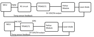

I am using TPS40170 for controlling TEC module ,currently I am controlling TEC by ON/OFF control ,byEN pin of TPS40170 .But with ON/OFF control  Reliability of our application is affected .
So we want control the TEC Module by PWM control ,I read from datasheet  that TPS40170 is PCM control buck controller, But I have a doubt ,In Which pin i have to feed the PWM signal ,
I need a help to design the PWM controlled buck controller using TPS40170  ,Input voltage is 24V and Expected output (1V-10V) using PWM control .
