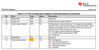

Hi Support team,
Because our products need to comply with the requirements of ErP regulations, we must reduce power consumption as much as possible in standby mode. We would like to ask whether the following two runtime controls are available.
  1. Set bit 1-0 of the 28h register to 3h to turn off the Type-C port, or set bit 10 to disable PD
  2. Control register to request different Sink PDO. For example, through the Autonegotiate function that 25751 can request up to 20V/3A sink PDO from the PD adapter. Can we request a 5V/3A PDO through commands or registers?
Thanks.
