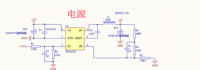

The customer want to add 220uF in input, 330uF in output.
Whether there is some potential risks?
Hi Fabio
The soft start time is 5ms for TPS54302. The iL need to charge Cout to Vout during Tss. so the OCP might happen during start up under large Cout (~mF).
iC=C*dv/dt, so the iL charging Cout will be 0.33A. Should be ok.
There should be no risk for the 220uF Cin.
