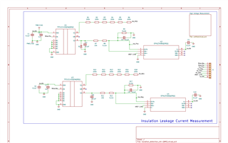

  • schematic_BMS_Isolation.pdf
    Please review the schematic of the BMS Isolation detection of 150Volts High Voltage battery .Is it correct or having mistakes .Please mark there and tell me how to make it correct.
  • Hello Nishant,
    Thank you for providing your 150V BMS Isolation detection schematic. The team will review the schematic and provide input within 24hrs.

  •  Want to clear that I am using BMS IC bq79731-q1 .And for that I want to clear that I want to do isolation detection for my 150 volts battery pack. I have to use external circuit with TPS12140-q1 solid state relay and OPAM circuit as present in the reference design of TIDA-01513. Or is there any feature in BQ79731-q1 IC to measure high voltage and calculate insulation resistance with tps12140-q1 as there is present in EVM schematic of TPS12140-q1. Please respond my query. And please give the design of Bq79731 and evaluation deign as i requested but not responded .And BQ79731-IC have Enable Pin ?  to enable digital Isolator .Please clear it Otherwise the  above schematic I shared is from TIDA-01513 and there OPAM and other circuitry used isolated supply and many more s shared in the schematic also. Please clear it

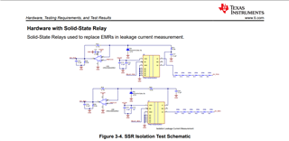

  • Hello Nishant,
    I took a brief look at the schematic you shared, and it looks very similar to the following schematic for leakage current measurement in TIDA-01513:
    Can you confirm that this is the schematic that you were following in your 150V BMS design?
    The TPSI2140-Q1 datasheet includes a detailed design procedure for using the part in Insulation Resistance Monitoring (detection) applications:
    Please consider the above Insolation Monitoring Topologies for your 150V BMS design and let us know which topology matches your design requirements so we may proceed with schematic review.
