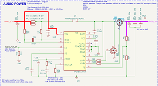

Hi Hope you can help find what I've done wrong...
We have two issues though these might be directly connected.
Firstly when the chip is not enabled, its passively passing 12V from the main rail to the target boosted rail. When I would have expected this to simply be off.
So it appears for some reason when not enabled the output HIGH drive mosfet is getting voltage to its gate, allowing the passive voltage through.
Not only this, while the chip is not enabled, it quickly reaches 45C. Suggesting some kind of short going on.
Outside of this, when the chip is enabled, it appears to work fine. Boosting voltage to a stable 20V and the chip cools down.
Here is our schematic for this circuit...
It was based from a generated drawing from the power designer(last summer), but when checking power designer again now some of the values have changed a bit...
Now I'm going to assume I've done something wrong here, I just hope some one can highlight what?
Or is this expected behaviour? Do I need to add a high side switch to block power when not enabled?
  • To add I just noticed the body diode, which of course means that would passively pass through voltage regardless of mosfet state.
    Been reading https://www.ti.com/lit/an/slvafo4/slvafo4.pdf which has suggestions regarding the passive power passing through...
    Doesnt explain the IC getting hot though. That Id like looking into still.
  • Hello Simon,
    You are right, A regular boost converter cannot disconnect the output, The input voltage will always go across the body diode of the high side FET.
    The schematic looks good.
    But I would recommend adding a ceramic 10uF capacitor also on the input side.
    From that schematic, I cannot see any obvious reason why the controller is running hot.
    For test purposes (to see if any current is drawn from the gate drivers), you might try disconnecting the FETs by removing the gate resistors.
    But please do not enable it in that case.
    With the gate resistors connected, please use an oscilloscope and have a look at the voltage on the VCC pin and the Boot pin.
    Is definitely nothing connected to the PGOOD pin?
    Please make sure that there is no short between any of the pins (also not to the thermal pad).
    Best regards
    Harry
  • PG is floating, if theres any shorts that would have been done by assembly/PCB fab. Ill probe and check.
    So apart from lacking an input mosfet to cut off the circuit and maybe a extra cap. Nothing really is wrong in the design? (thats some what a relief)

  • Hello Simon,
    It is not normal behavior when the controller runs hot.
    How hot goes it get? Coes it feel warm or hot? Do you burn your finger?
    If you can exclude the PG pin and also the LDRV and HDRV pins (by removing the gate resistors),
    the following ideas are left:
    - There is some kind of "short" on the VCC pin. Either you are connecting something to VCC that is not shown in the schematic, or the capacitor has a high leakage or is broken. Maybe replace the VCC cap with a different one (from a different vendor, if possible)
    - There is some kind of "short" on the BOOT pin. Maybe the capacitor has a high leakage or is broken. Try to remove the BOOT cap for test purposes
    - Some negative voltage is applied on any pin (e.g. the EN pin)
    - The controller IC is broken
    By the way:
    The EN pin has three levels:
    Between 1.2V and 40V: active
    Between 0.4V and 1.2 V: low current standby mode
    Below 0.4 V: shutdown mode.
    Best regards
    Harry
