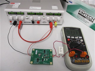

we have tried to measure the efficiency of the Evalboard using this parameters:
Vin = 48,05 V (measured)
Iin = 36 mA
Vout = 3,33 V (measured)
Iout = 333 mA (measured)
fsw = 800 kHz
From the result we only get an efficiency of about 64%. According to the datasheet it should be >70%. Can you please explain the difference? How can we get a better efficiency?

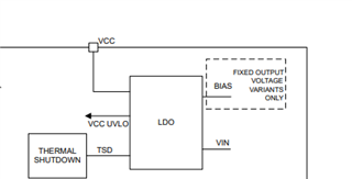

    One possible cause of lower efficiency is power dissipated through the internal regulator. Typically, internal regulator regulates to internal supply voltage through an internal LDO, so a higher input voltage would mean more power is dissipated through the regulator. If you use a fixed output version, the input of the LDO is instead connected through the output voltage which can supply the internal regulator with a lower voltage.
    Also, just as a tip, if you measure light load, you will need a device that has a longer averaging time, since the device is not switching constantly.

    With the device with longer averaging time, do you mean the DMM?

    Yes, we measure efficiency of the evalboard. The loss I'm referring to is internal in the device.
    Basically, the only way I see for you to get a similar efficiency as stated in the datasheet is to swap the device for fixed output voltage. The reason for this is that you are seeing massive power dissipation from the LDO, as the loss in the LDO can be approximated by the voltage drop across the pass element (48V-3.15V) multiplied by the current (Qg*fsw).
    For instance, let's say to turn on the high-side MOSFET, it needs a Qg of 3nC. Calculating losses with 800kHz switching frequency means you have seen about 0.1W loss while running at 3V, 0.3A, which is about 10% of your output power.
    But you are also right, clearly, there is some modification needed to the datasheet to be clear on what device is used to take the test.

    what's the reason for the difference in the LDO input voltage connection? Why can't the adjustable device has its LDO input also be connected to the output voltage? I see some other devices have a fixed lower voltage connected to the its LDO input. It would mean, the efficiency would improve right?
    Is it possible to tie the MODE/SYNC pin of the TPSM365R6V3 (fixed device) to GND (low) to get the device always in auto mode after power up?
    Theresia
  • Hi Theresia,
    It can be a few reasons.
    Assuming you are not using a standard 3.3V or 5V output rail, but instead wanted a 1.8V rail or 18V rail, you would see the efficiency loss at running a higher voltage, or not being able to power the LDO from the output. Only for specific output voltage rail would this feature be helpful.
    You may also consider a matter of noise. Adjustable device has external resistor dividers which has an associated noise with it, and can couple in with the LDO to affect other parts of the circuit. However fixed output voltage device already have internal resistor divider network, which has higher noise immunity.
    You can connect MODE/SYNC pin to GND to force PFM if it is fixed frequency device.
    Richard
