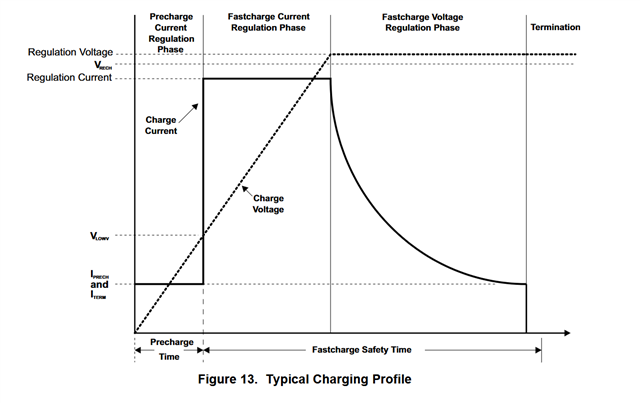

Hello, I am working on a charging system. In this system I have already included a MOSFET switch for the power source, a system to ensure no unwanted backwards current, and a coloumb counter for determining the charge of the battery as well as a microcontroller to manage all these aspects. I have a few questions about using the BQ24618 as a current regulator:

If I have already implemented a system to turn on and off charging based on the battery's estimated capacity, is it feasable to keep the device in the "current regulation phase" the entirety of the time it is operating and simply turn it off by toggling the CE pin? For example, if I want to charge a 6S li-ion battery and set the "Vbat" to 25V, could I simply turn the device on when I would like to charge the battery with a constant current and off when I have detected that it has received enough charge and have it stay in the "current regulation phase" the entire charging cycle?

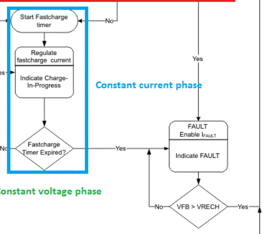

Is the fastcharge timer the same as the safety timer and is it reset if the device is turned off and back on again by turning off and on the CE pin? I do not see the "fascharge timer" mentioned anywhere else in the documentation.
    I don't see any obvious issue that would prevent this.
    Yes, they are the same. It's the Fastcharge Saftey Timer.

    Also, would you recommend that I pull the TTC pin to GND or VREF to not have the timer as I already have a system for managing the battery's safety?
    I would recommend pulling up to VREF.
