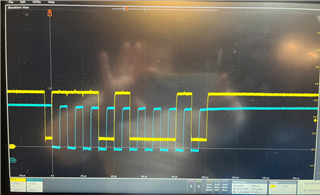

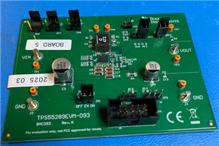

We procured two pcs TPS55289EVM-093 from Mouser and Digi-key respectively.
Both of them are not working.
we use AMD FPGA to drive TPS55289EVM-093. I2C is 100KHz.(Oscilloscope Waveform is shown below)
Input volt is +24V, after power on, we confirmed EN is high (about +10.5V) and VCC is about +5.2V.  (Jumper setting on EVM is shown below)
Could you guys kindly help me??
Thanks very much for help!
