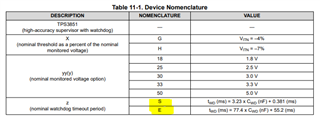

Hello, I'm looking for a 1.8 V model and under package information I found three models: TPS3851G18E, TPS3851G18S and TPS3851G18H. Can you please let me know what they stand for?
Hi Devis,
The E and S are designates the timing scaling, while H should designate the threshold of the voltage monitor. The usage of H on that model is invalid.
