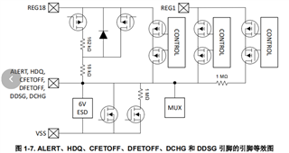

The BQ76952PFBR communicates with the main control unit through the IIC. After the BQ76952PFBR is powered on, the battery voltage data uploaded by the AFE is sometimes unavailable, and the main control unit reports a communication fault. Then we did the failure analysis, and it was found in the analysis report that PIN30-DEFTOFF suffered electrical damage. Is there any causal relationship between this and IIC's failure to communicate after a period of time? I didn't see any connection between the two from the DEFTOFF pin equivalence diagram.
This pin is suspended, how can we prevent EOS

    Can you clarify more about this? Is the device NACKing or is the SCL line held low? Do you have any logic analyzer files of this? What was the voltage of REG18 and REG1?
    If the IC was damaged, it can be difficult to determine its behavior. Do you mind sharing the circuitry around the DFETOFF pin?
    Depending on how it’s configured, the pin will have different recommended operating voltage ranges. This is shown below and can be found in Section 7.3 Recommended Operating Conditions of the datasheet.

    2. The PIN30 pin function is not in use. It is floating according to the recommended datasheet, and there is no circuit around it
    Have you tried connecting DFETOFF to VSS as well to see if that has helped?
