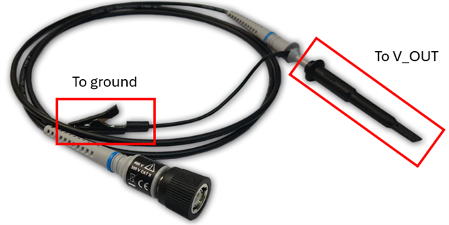

  • Hi Richaed,
    I didn't use the tip and barrel setup to probe vout.
    Instead, the vout was connected with the tip of the passive probe and the probe was coonected to ground with an allegator clip.
    This is the passive probe I used:
    I will update you on how the vout waveform looks like once I get the resul!
    Thanks!
    Ian Chou
  • Hi Ian,
    When probing VOUT with the ground lead, it may actually pick up a lot of the switching noise so it is difficult to tell what part of the waveform is due to the switch node and what is due to the output voltage falling. Let me know once you get the results.
    Richard
