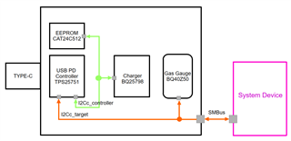

TPS25751:I2C communication between EEPROM / PD control / BQ25798 / Gas Gauge / system
Part Number: TPS25751
Other Parts Discussed in Thread: BQ25798,
Reference to my block diagram.
Is it availabled for I2C communication between EEPROM / PD control / BQ25798 / Gas Gauge / system.
tks.
Mulin
  • Hi Mulin,
    The TPS25751  supports the 4CC commands "I2Cr" and "I2Cw", which allows a user to send commands to the I2Ct port of the TPS25751 that trigger I2C reads and writes on the I2Cc port. This allows users communicate with I2Cc peripherals from the I2Ct port.
