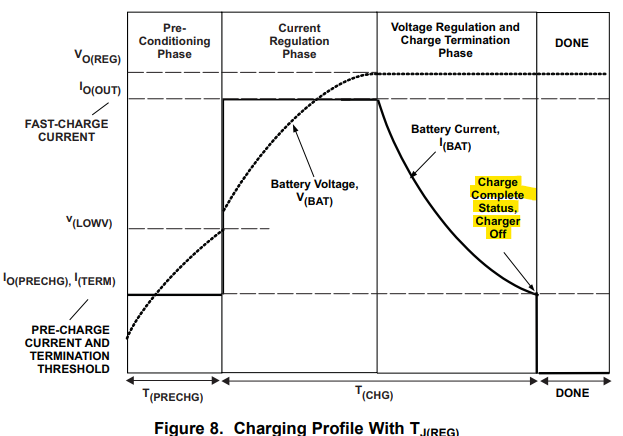

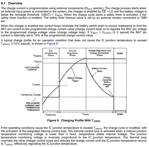

If you look at Figure 8. Charging Profile in BQ24085 datasheet, you can see that Io(OUT) output is supplied and charged to the battery with a steady current until V(BAT) = Vo(REG) is reached, and when V(BAT) = Vo(REG): 4.2V is reached, the current decreases and charging ends.

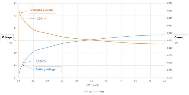

However, during actual measurement, it was confirmed that BQ24085 OUT(10pin) output current decreases when Vbat(9pin) reaches approximately 3.8V.
[Actual measurement graph]
Please check why this part is like that.

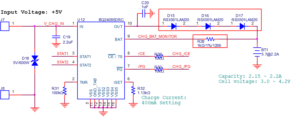

  • Hi, Alec
    Please refer to the schematic below.
    - BQ24085 Output (10 pin) D15~17 are diodes added to the output pins because they require authentication-related safety elements. (Cannot be excluded)

    Q2) In the EV-kit schematic, the resistance connected to the BAT (9pin) is 390Ω, but the actual application was tested with 1kΩ. Is this a problem?

  • Hello Grady,
    Thanks for sharing the customer's schematic.
    1. The three diodes between OUT and the battery introduce a significant voltage drop. As a result, the battery never sees the full regulated charge voltage from the charger, which affects how the battery charges. This behavior is expected with those diodes in place.
    2. The BQ24085 datasheet recommends using a 390ohm from BAT to OUT when the output current is under 200mA. The 1k in your customer's design could also be influencing charge behavior, but the main issue is the voltage drop caused by the diodes.
    3. The dropout voltage is 600mV (maximum) for IOUT=750mA and varies with temperature, as shown in Figure 7 in the datasheet.
    I understand the customer may be unable to remove those diodes, but I recommend removing them temporarily to see if the behavior improves. If it does, they may consider alternative solutions to protect their battery.

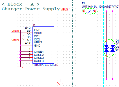

    Q2) I want to supply power to the BQ24085 IC using a USB-C connector. I would like to ask whether the default voltage (5V) is output when there is no separate communication after connecting to a voltage-related charging adapter supplied by USB-C type.
    (If I attach a circuit diagram, only the power line is used from the USB-C type connector.)

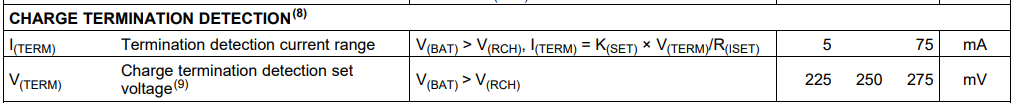

    1. Charge will terminate when the charge current falls below the termination current threshold (ITERM) or if the charge safety timer expires. The voltage on the ISET pin is compared to V(TERM) to determine when termination should occur. ITERM is set based on RISET, as shown in the table below:
    2. A 5.1k pull-down resistor is required on each CC line for 5V.
    Alec
  • Hi, Alec
    Thank you for support.
    Referring to the reply, I connected 5.1kΩ pull-down resistors to CC1 and CC2 respectively to ensure that 5V is always supplied for USB-C type charging, as shown in the circuit below. Please check if there are any problems.
    Thank you.
  • Hi Grady,
    Yes, that is correct.
    Let me know if you have any other questions.
