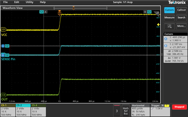

I use a reset IC, the part name is TPS3808EG30DBVRQ1(2.8V threshold), but when I give a under threshold voltage in first time start, why the IC output a high voltage?
In my opinion, there should output a low voltage, right?
CH1 : VCC
CH2 : SENSE
CH4 : OUT
VCC = 3.3V, SENSE = 2 V

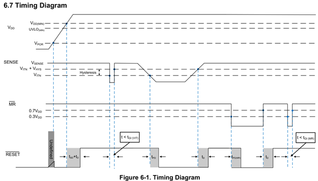

below picture is this IC timing sequence

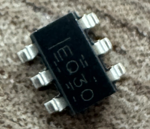

    Could you please share the top mark of the IC?
    Sila Atalar
  • Hello Sila, please see this attached picture
  • Hi Qin, Thanks for sharing the top mark. I just wanted to first make sure you have the correct device. It seems like TPS3808EG30DBVRQ1 is the correct OPN.
    Your understanding is correct, normally the reset should be low when VDD:3.3V, Vsense:2V, and MR= High for TPS3808EG30DBVRQ1
    According to datasheet the RESET behavior at start-up is depend on both VDD and SENSE voltage. (When MR is High)
    1. VDD needs to higher than VPOR, which is 1V for TS3808E-Q1.
    2. VDD_MIN =1.7V, and if VDD_MIN > VDD voltage >VPOR, the RESET should be asserting without checking the SENSE voltage.
    3. If VDD> VDD_MIN, then SENSE voltage is the main input that will affect the output behavior
    (Please check section 8.4 Device Functional Modes for more information)
    Can you please keep VDD > VDD_MIN and Start Sense voltage from 0V, at this point Reset should be low. Increase the SENSE pin voltage gradually to see at what voltage it will become high? This way we can understand what voltage is de-asserting.
