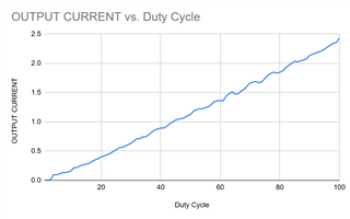

I have designed CC driver controlling through Shunt Fet at 25Khz PWM frequency
I am not getting proper linear out and the LEDs are also flickering at particular values like 52% intensity
Vled = 27V
Iout = 2.5A
Vin = 36V
L = 47uh
Fsw = 458khz
D = 0.85
Ron = 24k
Con = 1nf
Rvout1 = 100k
Rvout2 = 10k
Cout Cap = 0.1uf
VIadj = 0.2V
Rcs = 0.08E

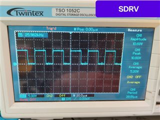

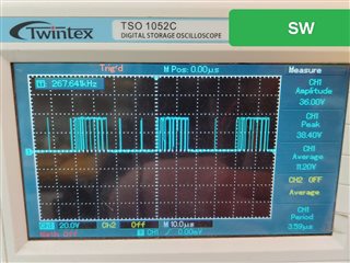

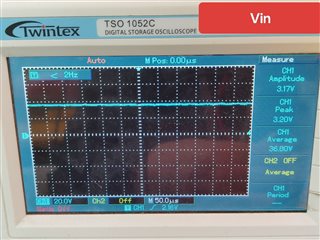

I am attaching all reading from my DSO at 40% Duty Cycle, at this value there was no flickering
VIN

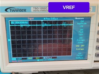

Vref

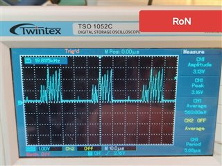

RON
COMP
SDRV
CS
SW

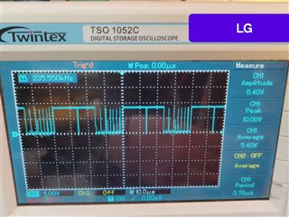

LG

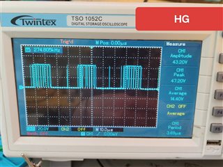

HG
VOUT
Output current vs Duty Cycle graph
Current Readings
Duty Cycle OUTPUT CURRENT

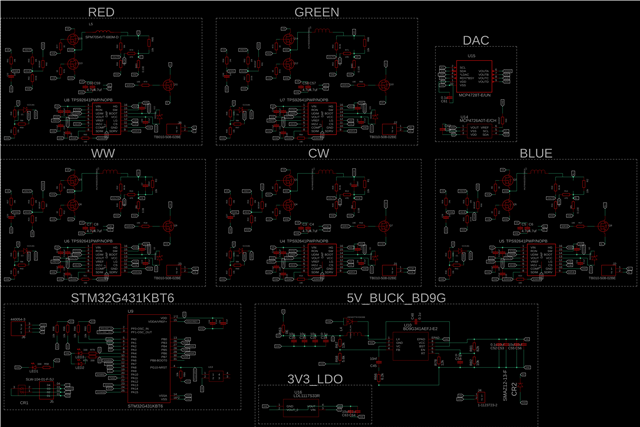

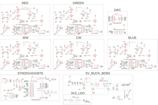

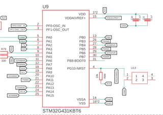

  • Also attaching Schematic for reference
  • Hi Rahul
    The schematic is not clear, can you please re-attach the file? And can you please share what's the end equipment ?
    Thanks and best regards.
  • I am using TPS92641 for LED panel controller
    Panel is 9 in series and 18 in parallel
    I selected TPS92541 for high resolution pwm dimming as it supports 20000:1 Shunt FET PWM Dimming
    Also, does it support this range at any frequency or is there any pwm frequency limit?
    For reference i have attached both png and pdf of schematic
     TPS_SCHv5.pdf

  • Have you found any issues in my schematic or the DSO waveforms I shared of all the pins of IC?
  • Hi Rahul
    The schematic looks ok to me.
    The RON waveform, the voltage amplitude seems not stable, can you please measure the RON when there is no shunt dimming?
  • Hi Gui,
    I have attached a video file of RON signal in multiple grids for better understanding, please check and let me know how can i improve linearity.
  • Hi Rahul
    My thought is that you can make lower dimming frequency (but there is requirement we need >20kHz here) or higher switching frequency. Can you use higher fsw? I think reducing the output current ripple might also help, this can be achieved by larger inductance/higher fsw/larger Cout.
