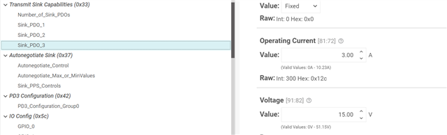

  • Hi Aya,
    We cannot use the application to configure the IC as per our requirement so we want to know the process to set the PDO value to 3 and set the output voltage as 15V with 3A current in the TX_SINK_CAPABILITIES register.
    Please refer to following image to see the values we need to update but without the customization tool.
    I tried to directly write the value the TX_SINK_CAPABILITIES register with the values defined in the application but the values are not getting updated in the register. I checked it with and with the EEPROM connected.

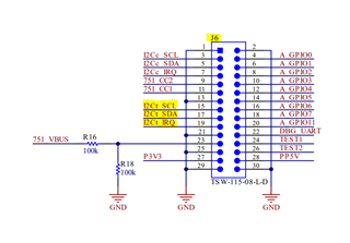

    I am following the instructions you refered to from the TRM, I have connected the VIN_3V3 and the IRQ_t pin of the EVM to my MCU and the EEPROM is disconnected so the USB-PD controller is in "PTCH" mode. Now the second step is to read the INT_EVENT register, which is read empty. Can you tell me the reason for this?
    I also have another query, I wanted to know what is the default output voltage for the IC when the configuration is not set yet?
  • Hi Runita,
    Could you share a block diagram of your connections so that I can fully understand your setup? Do you have the I2Ct_SDA and I2Ct_SCL pins connected to your MCU as well?
    What is the ADCIN configuration set to on the EVM? How is the EVM being powered?
    Aya Khedr
  • Hi Aya,
     We cannot share the block diagram with you but I can explain the connections to you. The I2Ct pins are connected to our MCU,  and the ADCIN configuration is:
    ADCIN1- 7, ADCIN2- 5.
    The EVM is getting the power through J3 connector connected to a 65W power supply with C type connection pin.
    Can you clarify me that if I want to read the interrupt events specified in the register like if the plug is connected or not what is the procedure from the FW? and the pin configuration (I2Ct_SCL, I2Ct_SDA, and IRQt pin) with the USB-PD controller and MCU along with any power specifications.

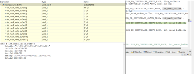

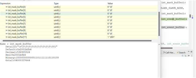

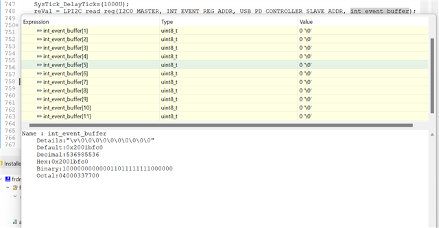

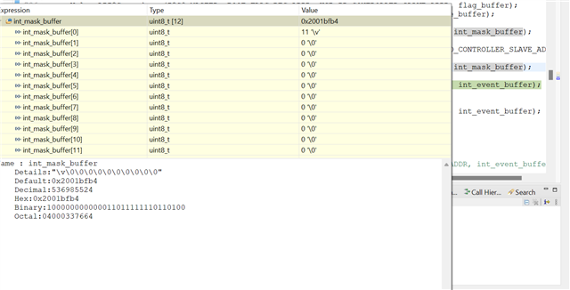

  • Please see the below process to read the INT EVENT reg for the Patch bundle ready interrupt on the 81st bit of the register:
    in the first step the mask is set for the interrupt in the INT MASK reg(0x16), then the bit written is confirmed by reading the mask register and then the interrupt event is read but the register is still read empty.
    reVal = LPI2C_read_reg(I2C0_MASTER, INT_EVENT_REG_ADDR, USB_PD_CONTROLLER_SLAVE_ADDR, int_mask_buffer);
    int_mask_buffer[11] |= 1;
    reVal = LPI2C_write_reg(I2C0_MASTER, INT_MASK_REG_ADDR, int_mask_buffer, USB_PD_CONTROLLER_SLAVE_ADDR,
    11);
    reVal = LPI2C_read_reg(I2C0_MASTER, INT_EVENT_REG_ADDR, USB_PD_CONTROLLER_SLAVE_ADDR, int_event_buffer);
    SysTick_DelayTicks(10U);
    I2C logs:
    Step 1: mask is set
    Step 2: interrupt event register read after the delay
    Let me know if any process is wrong or anything else needs to me changed.
    This above process is in "PTCH" mode.
    Another observation is that when I try the same process in "APP" mode this event register is set according
    to the mask properly.

  • Hi Aya,
    Do you have any update regarding this issue? We need to check if the patch file can be uploaded without EEPROM and GUI tool as soon as possible and I am still not getting the int_event_reg bit related to the device is ready to receive the patch file, I have tried to use the INT_MASK_REG to set the interrupt but this register is also being read empty without the EEPROM.
    write buffer:
    read buffer:
  • Hi Runita,
    Please ensure that J16 is removed (EEPROM disconnected) and that I2Ct_SCL, I2Ct_SDL, I2Ct_IRQ, GND are all connected to your MCU.

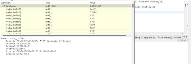

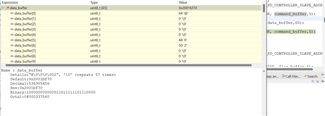

  • Hi Aya,
    Thanks for the reference, I tried to send the same data as per this application note and please check the data register buffer log to confirm if I am getting the correct response form the DATA1 register for command "PBMs".
     this is the response after PBMs command
    According to my understanding the command was successful so I sent the patch bundle and then the PBMc command, But now I am getting the following value in the DATA1 register. The CMD1 register is giving the correct response according to the application note reference.
     this is the response after PBMc command.
    Note that my patch bundle transfer was successful.

  • Hi Aya,
    After the burst data is transferred successfully I sent the command "PBMc", the CMD1 register is cleared as per the method but the DATA1 register is not getting cleared according to the application note and the TRM, I have shared my DATA1 register value in the above message's second image.
