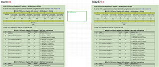

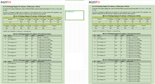

Could you give some guidance what's happening in PD controller for the cycling and why there is 2x OTG parameters:  5000mV / 1750mA  &  5144mV / 450mA, why OTG current parameter is not 3000mA as defined in source PDO? (as confirmed, the BQ25723 and BQ25731's OTG register is same)
