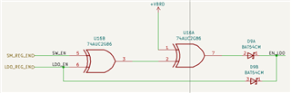

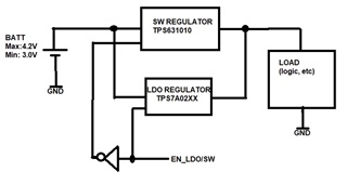

I need to know if the TPS631010 can be connected in parallel to an LDO like this
The load here is an ESP32 cpu that may operate with WiFi and maybe an LTE module (I have to check this yet)
but the idea is that while the CPU is operating in low power or sleeping, the power be delivered by the LDO, and when
the CPU is about to operate in higher power (writing SD card or starting a WiFi operation) the Switching regulator takes over
Can the TPS631010 operate in such way? Can the LDO regulator also be connected in that way? If not, what are the parts that can work?
