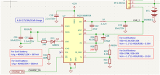

Hi TI support team:
I have picked the BQ25306 for my charger as schematic below. I have a question about the STAT pin blinking frequency,
when I remove the battery from the charger It blinks about 10Hz other than 1Hz as the datasheet scribed.
I red some of the previous posts about the same question, but not understand what exactly the cause of the blinking frequency.
Would you please explain what component would change the frequency ? This is important that we want to take the LED to be
the charger status display to the user, but we don't want it flashing fast.
