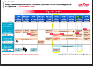

    For the connector side high speed traces:
    make sure the CMC bandwidth is sufficient for datarate desired

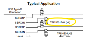

    The Clamping voltage of the ESD may be too high. Aim for a value closer to 5V
    [MSY]_Do you have any recommendation here?
    [MSY]_Datasheet of TPD1E01B04 says, this is applicable to USB-C ESD protection.
    Do you still think that, need to change this?

    For CMC I use the following parts as a recommendation:
    For ESD, we recommend a lower clamping voltage as this has a better impact with TI parts. I recommend using the PUSB3FR4.
