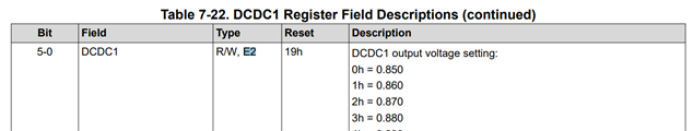

  • Hi Conor,
    There is some difference in the two devices. It will depend on exactly what registers you are planning to change, only those marked "E2" in the TPS6521855 register map will be able to be burned into the EEPROM and stay programmed upon power cycle:
    Else, the TPS65215 will need to be chosen to effectively program all registers of the device.
    More details can be found in the responses to this thread: https://e2e.ti.com/support/power-management-group/power-management/f/power-management-forum/1056661/tps6521855-eeprom-programming-preprogrammed-device
    For this reason, an entirely custom part with full configurability will be priced higher than the pre-programmed part with fewer configurable settings.
    Generally, the -55 is specifically chosen to partner with the AM64x.
    For other processors, the closest variant to the required specs is often chosen as a starting point. Else, we would typically see a the TPS6521815 used if the processor requirements were drastically different.
