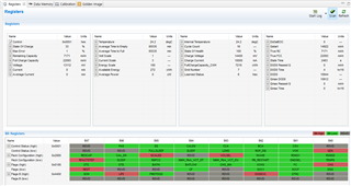

BQ34Z100: The CHG bit of Flags is always high.
Part Number: BQ34Z100
I completed the learning cycle using the LFP battery.
I created a golden image, created an srec file, and downloaded it to another board and am using it.
During use, the battery power was disconnected, so I downloaded the golden image again and calibrated the CC Offset, current, voltage, etc.

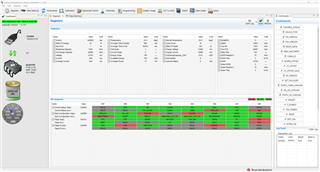

From here, the current is different from the actual measured value, and the CHG bit of the Flags is always high.
The actual current consumption measured with a current meter is 4A, but it is less than 1A in Bqstudio. What is the problem that the CHG bit is always high when the power is connected only to the BQ34Z100???

  • GPC is using 400.
    There is a deviation of about 9%, but there was no problem with the learning cycle and use.
    The important point is that I have been using the battery gauge normally until now.
    I re-downloaded the golden image and then the problem occurred.
    The current consumption is expressed as about 12.5% ​​of the actual measurement. (8 times difference)
    And the charging bit is always on while discharging.
