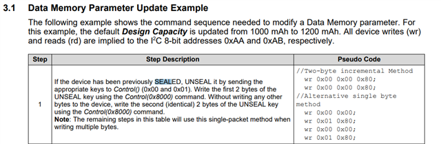

I have implemented and tested command input via control (reading statuses and flags, reset commands, BAT_INSERT command, etc.). But for some reason, the sealing and unsealing commands via control do not work. I managed to seal via memory access(UPDATE_STATUS |= 0x80). After that, I cannot unseal the device via control. What can I provide to better describe the situation? What should I pay attention to?
The default value of the unsealing key was checked. The unsealing command is sent twice in two multibyte transactions (and single ones were also checked).
Is it important in what state the training cycle is carried out (sealed or unsealed)?

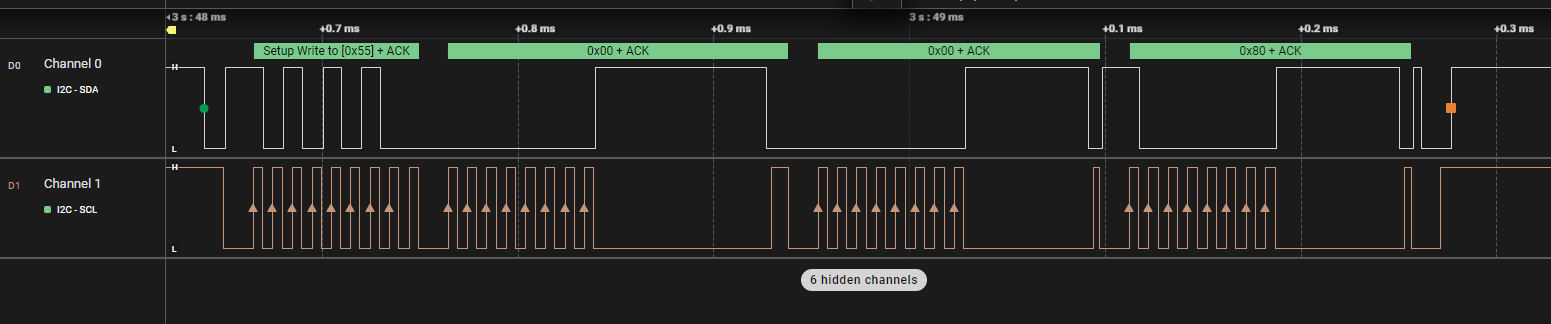

    The keys are sent consecutively, with no other data being written to the Control() register in between, as recommended by the datasheet. These are two multi-byte i2c transactions. The pause between commands is several milliseconds. But I tried to increase the pause between sending commands to 0.1-1 second. I have attached a logical analyzer graph.
    The sensor resistor is 7 mOhm.
  • Hi Pavlo,
    Thank you for sharing the image, is there any difference if a single byte method is being used?
    Anthony
  • Yes, I tried the single byte method as described in the parameter update example table. I didn't get any noticeable difference, the result was the same.

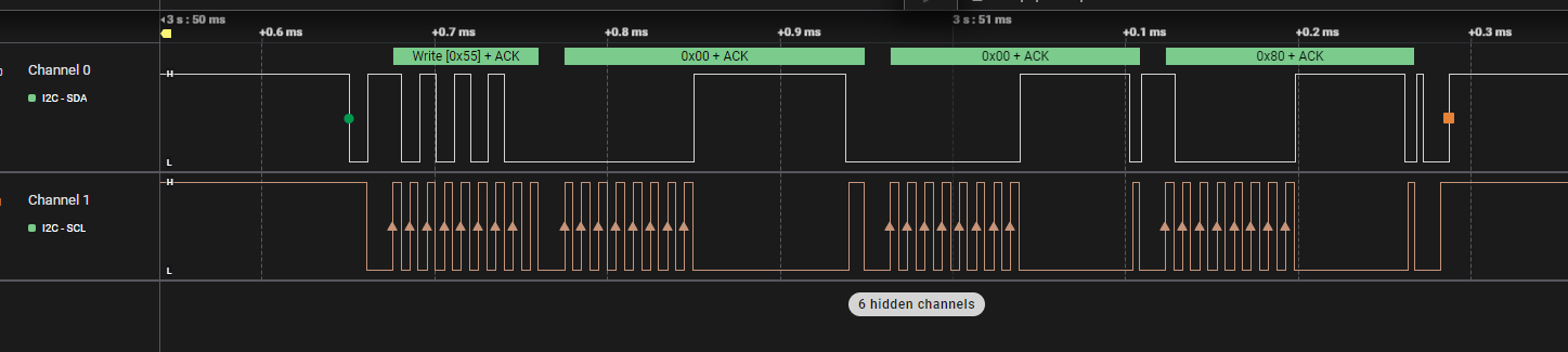

    Thanks for confirming, I recreated a successful unseal on one of our boards to where the logic capture can be found below:
    First command:
    Second command:
    Delay between:
    What is the clock frequency at this time?
    Anthony

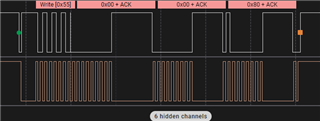

    Thanks for confirming, 100kHz should be fine here. Would it be possible to get a closer image of the two commands sent so we can check?
    Also, do you have an EV2400 to where this can be checked with a different host?
    Anthony

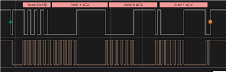

  • Hi Anthony,
    I'm attaching a more detailed image of both commands from the image above.
    Unfortunately no, I can't check with another host right now. Based on the graphs above, is it possible to understand the relevance of testing with another host? Perhaps I can get some COM-I2C.
    Thanks!
  • Hi Pavlo,
    Thanks for sending the closer images, it seems like our logic analyzer captures are close to identical. I will consult our team to see if there is anything missing. Just to confirm, is this currently reproducible on multiple devices?

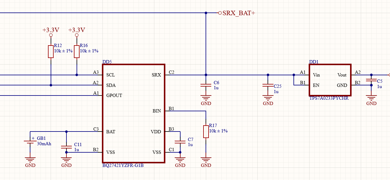

  • Hi Anthony!
    Is this scheme enough? The srx_bat contact also receives charging. There was a GLF73910-BD01 protection chip between the battery and the fuel gauge, but it is now shunted.
    As soon as there is news about new devices, I will write whether there are changes or not.
  • Hi Pavlo,
    Thanks for sending this image, I do not see any issues with how the communication lines are set up. Are there any components intermediate between the host and gauge on these lines or just the pullups?
    Anthony
  • Hi Anthony,
    There are nothing, just the pullups.
    Thanks!
  • Hi Pavlo,
    Thanks for confirming, are their any oddities not shown on the board with the I2C lines? Maybe very long routes between the host and device?
    Anthony
