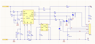

您好,能帮忙评估下bq27z561的原理图吗?有没有什么缺陷?谢谢了!

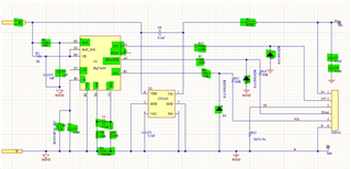

    It appears that you did the schematics correctly the only confusion is that I couldn't find the part information associated with CT2105. But either than that you did the schematics for the battery gauge correctly.
    *Green means good
    Thank you,
