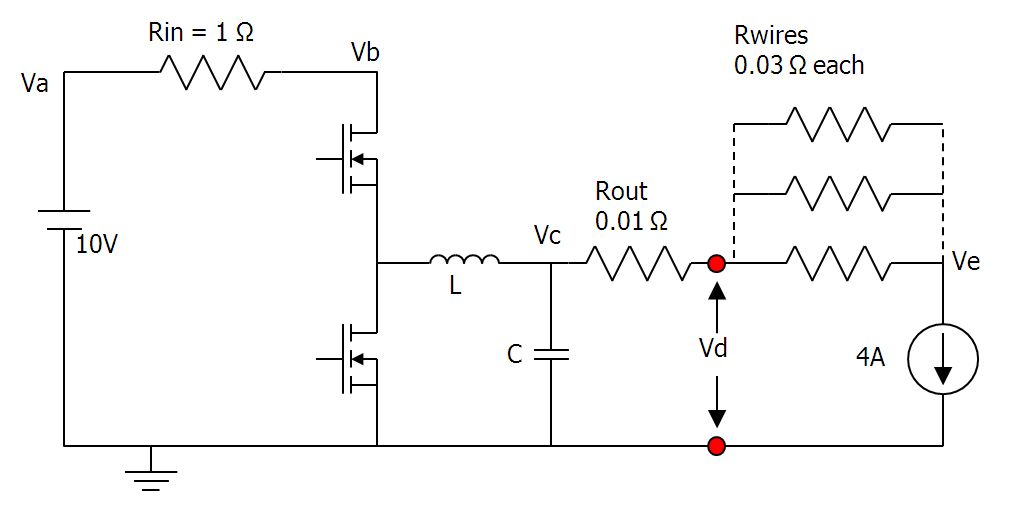

  • PW,
    You do not need to solder the load wires directly to the L or the input cap. You just need to measure the voltages at those points. While it is true that there will be voltage drop in the wires and even the copper on the board, those drops do not matter for the calculation of efficiency (of the power train). That’s why it was suggested to measure Vin and Vout as discussed. Again, there will be voltage drops in the copper, but the suggested measurement points will not include those drops. That was sort of the whole point of the discussion, that every design will be different, so measuring the efficiency in a way that includes voltage drops that have nothing to do with the power train will only lead to incorrect results. Let’s take some simple numbers. See attached schematic. Let’s say your system is:
    - Vout = 1.2V
    - Vin = 10V
    - Iout = 4A constant current for simplicity. Your actual load is constant resistance (power resistors) and the calculations would be slightly different, but the resulting efficiency would be identical.
    - Input wires, connectors and copper board = 1 ohm
    - Output connectors and copper board = 0.01 ohms total
    - Output wires, each 18AWG wire 0.03 ohms
    - For simplicity, ideal ground input and output (so, zero ohms)
    Rin represents the combined resistance of the input wires, input connectors and input copper. Rout represents the combined resistance of the output copper and connectors. Rwires represents the load wires. One load wire is 0.03 ohms, a bundle of three would be 0.03/3=0.01 ohms.
    The red dots represent the voltage sense points for the controller, often the output connector. This is the point at which the controller measures the output voltage and regulates as desired, in this case 1.2V. So under normal circumstances, no matter what the operating point (Vin, Iout), this is regulated at 1.2V (that’s the whole point of the regulator, a constant voltage at the sense points). As you change the load, the voltages at Vb, Vc and Ve will all change. The voltage at the ideal battery and the controller sense points Vd will not.
    If you go through the circuit and measure the input voltage at Va or Vb, and the output voltage at Vc, Vd or Ve, your resulting efficiency would be:

    These results point out a few things. If you notice, the efficiency from Va or Vb to Vc or Vd do not change with one wire versus 3. That is because the change in the circuit (one 18AWG load wire versus 3) did not change anything at all in that part of the circuit (Va through Vd). What it did change is the drop between Vd and Ve. So while Vd is still regulated to 1.2V and supplying 4A, there is only 1.08V remaining at the load (that was expecting 1.2V). With three 18AWG wires the drop between Vd and Ve is lower, and there would be 1.16V remaining at the load.
    If you start adding copper wire to the input side, you would see the calculation of efficiency from Va to Vc, Vd and Ve change in the same way.
    So if all that makes sense, then we might want to conclude that your wires affect the efficiency of the TPS40322 and the power train on the EVM. But that of course is not correct. If nothing on the EVM has changed, then the efficiency should not change either. In fact it hasn’t, if you look at the efficiency number from Vb to Vc. No matter what you do to the input wires or output wires (within reason such that the EVM is still operational), that number won’t change, so your efficiency measurements are not subject to the test setup. That’s why you should measure the efficiency from Vb to Vc. But you do not have to connect the input to Vb or the load to Vc, you just need to measure the voltages there.
    With that said, even the efficiency from Vb to Vc will change depending on some factors such as the value of Vb (eff versus line) and the value of Iout (eff versus load) and the operating temperature (eff versus temp, not usually specified for an EVM). That’s why there are curves of Eff versus line and Eff versus load. Room temperature is assumed for EVMs.
