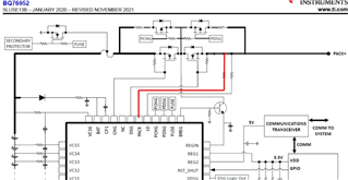

I am planning to use two BQ76952 in my design. For the Pack pin connection, can both devices share the same Pack pin, or should it be separately routed like the SRN/SRP pins?

Hello Tom,
Do you mind sharing who is this customer? Why are they using two AFE's?
They need to have separate traces for every measurement pin.
