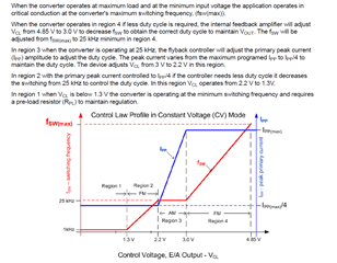

Hello Mike,
In that case why the MOSFET turn-off current was taken as I_pri_peak?
As per my understanding I_pri_peak is the peak primary current at V_bulk_min.
According to you it should be the current at V_bulk_max right? Since the Vds voltage is taken as V_bulk_max + V_flyback.
