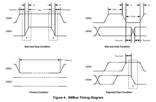

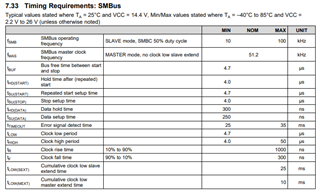

  • Hi Ashutosh,
    What is the Valid Update Voltage at this time? There should be no difference in the communication between rest, charge, and discharge, can you please confirm that the communication waveforms meet the thresholds below? During discharge, is there any chance the gauge is going into shutdown?
    Anthony
  • Hello Anthony,
    I confirmed the communication waveforms meet the thresholds. The problem is still there during discharging cycle.
