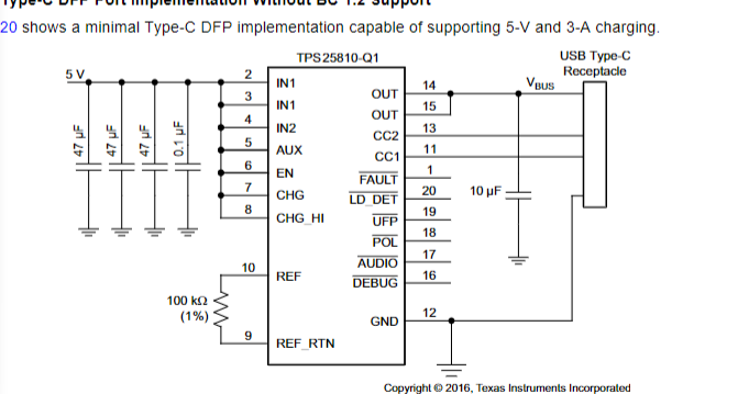

My customer wants to do the charger with 5V2A in DFP mode. Below is the sch, which support 5V3A that is same as the sch in datasheet:
Now they tested the output current is only 1A. The charged device is normal when they change to other charger and the charge current is around 2A.
in addition, to avoid the influence of T1, they shorted it but having same result 1A.

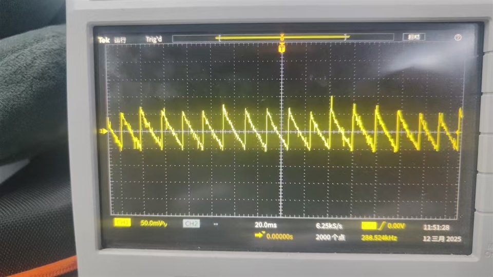

The output voltage waveform is as below:
Do you have any idea to check the issue?
